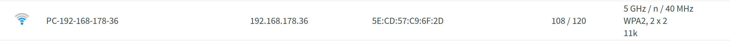

  • Auf Debian Buster 10 sieht das dann so aus.
    frank@debian:~$ iperf3 -s
    Server listening on 5201
    Accepted connection from 192.168.178.30, port 52698
    [  5] local 192.168.178.36 port 5201 connected to 192.168.178.30 port 52700
    [ ID] Interval           Transfer     Bitrate
    [  5]   0.00-1.00   sec  2.22 MBytes  18.6 Mbits/sec
    [  5]   1.00-2.00   sec  2.35 MBytes  19.7 Mbits/sec
    [  5]   2.00-3.00   sec  2.13 MBytes  17.9 Mbits/sec
    [  5]   3.00-4.00   sec  2.14 MBytes  17.9 Mbits/sec
    [  5]   4.00-5.00   sec  2.15 MBytes  18.1 Mbits/sec
    [  5]   5.00-6.00   sec  2.10 MBytes  17.6 Mbits/sec
    [  5]   6.00-7.00   sec  2.16 MBytes  18.1 Mbits/sec
    [  5]   7.00-8.00   sec  2.12 MBytes  17.8 Mbits/sec
    [  5]   8.00-9.00   sec  2.30 MBytes  19.3 Mbits/sec
    [  5]   9.00-10.00  sec  2.20 MBytes  18.4 Mbits/sec
    [  5]  10.00-10.04  sec  83.4 KBytes  18.0 Mbits/sec
    [  5]   0.00-10.04  sec  22.0 MBytes  18.3 Mbits/sec                  receiver
    Accepted connection from 192.168.178.30, port 52702
    [  5] local 192.168.178.36 port 5201 connected to 192.168.178.30 port 52704
    [ ID] Interval           Transfer     Bitrate         Retr  Cwnd
    [  5]   0.00-1.00   sec  2.42 MBytes  20.3 Mbits/sec    1    124 KBytes
    [  5]   1.00-2.00   sec  2.42 MBytes  20.3 Mbits/sec    0    219 KBytes
    [  5]   2.00-3.00   sec  2.17 MBytes  18.2 Mbits/sec    0    317 KBytes
    [  5]   3.00-4.00   sec  3.29 MBytes  27.6 Mbits/sec    0    428 KBytes
    [  5]   4.00-5.00   sec  3.11 MBytes  26.1 Mbits/sec    0    559 KBytes
    [  5]   5.00-6.00   sec  2.43 MBytes  20.4 Mbits/sec    0    662 KBytes
    [  5]   6.00-7.00   sec  2.50 MBytes  21.0 Mbits/sec    0    800 KBytes
    [  5]   7.00-8.00   sec  2.50 MBytes  21.0 Mbits/sec    0    930 KBytes
    [  5]   8.00-9.00   sec  2.50 MBytes  21.0 Mbits/sec    0   1.02 MBytes
    [  5]   9.00-10.00  sec  2.50 MBytes  21.0 Mbits/sec   18    498 KBytes
    [  5]  10.00-10.14  sec  0.00 Bytes  0.00 bits/sec    0    526 KBytes
    [  5]   0.00-10.14  sec  25.8 MBytes  21.4 Mbits/sec   19             sender
    Das ist schon mal deutlich schneller, als bei dem Test vorher.
