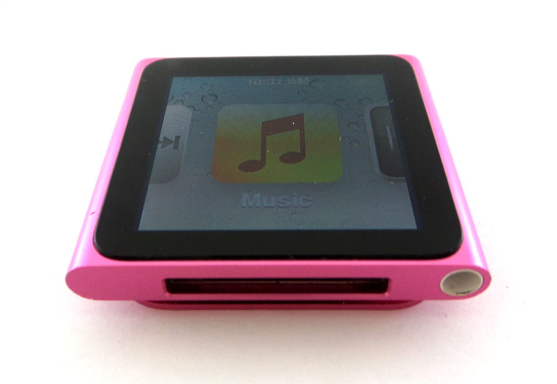

    Let’s ignore the iPod nano 6th gen, which managed to fit a 30 pin dock connector and a headphone jack into a watch sized body
  • If you mean a USB-C port in general, they can be made waterproof. If you mean something specific to putting one in the most compact form factor possible, that might be true.
    They can be waterproof but are also non functional until the water is fully cleared from the port.
  • Let’s ignore the iPod nano 6th gen, which managed to fit a 30 pin dock connector and a headphone jack into a watch sized body
    With vastly lower power requirements compared to a smartwatch
